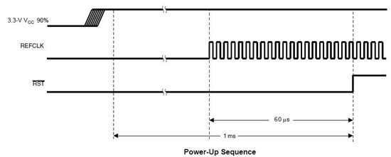

I am Implementing a TUSB2077A and am not getting any data coming across.
First of all let me say:
The #BUSPWR is set to 3.3 v
The P4 Type A plug has no voltage wired to it.
The P5 Type A plug does have voltage wired to it. (With nothing plugged in, I read 0.22 volts on the Out1 of the power distribution switch).
The un-used ports, #OVRCUR5 is floating,
                                     DP5 is floating,
                                     DM5 is floating.
and same for Port 6 and Port 7.
Is there any-thing here that seems would be causing an issue?
Any troubleshooting suggestions?
