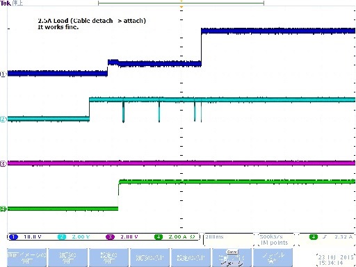

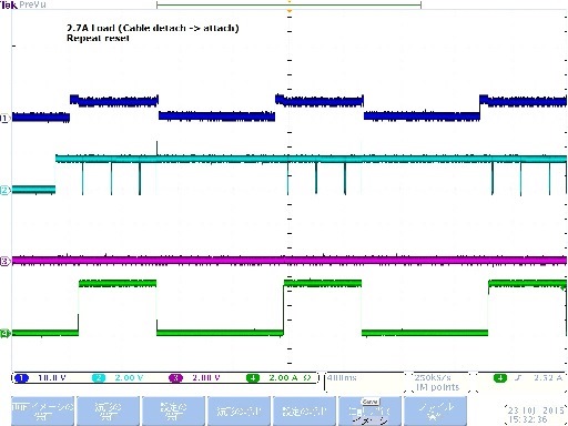

  • Karl,
    I attach 2 oscilloscope shots of VBUS, CC1, CC2 and current.
    2.5A or 2.7A load was applied to J6 on TPS65982 EVM.
    It worked fine for 2.5A load, however reset was repeated when 2.7A load was applied.

  • msmn,
    Are you applying an analog load (resistors) or an electronic load?
    I cannot see because the resolution of your scope shot pictures is very low, but what is the voltage on VBUS?
    Is VBUS = 5V, 12V, or 20V?
    It sounds like you are applying the load before the TPS65982 is aware that there is about to be a Load.
    Have you tried the test by applying the load after the PD contract is negotiated?
    If you apply the load too early, it may be an accidental violation of the spec and could cause issues.
