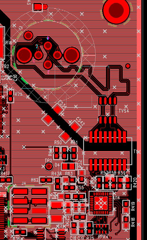

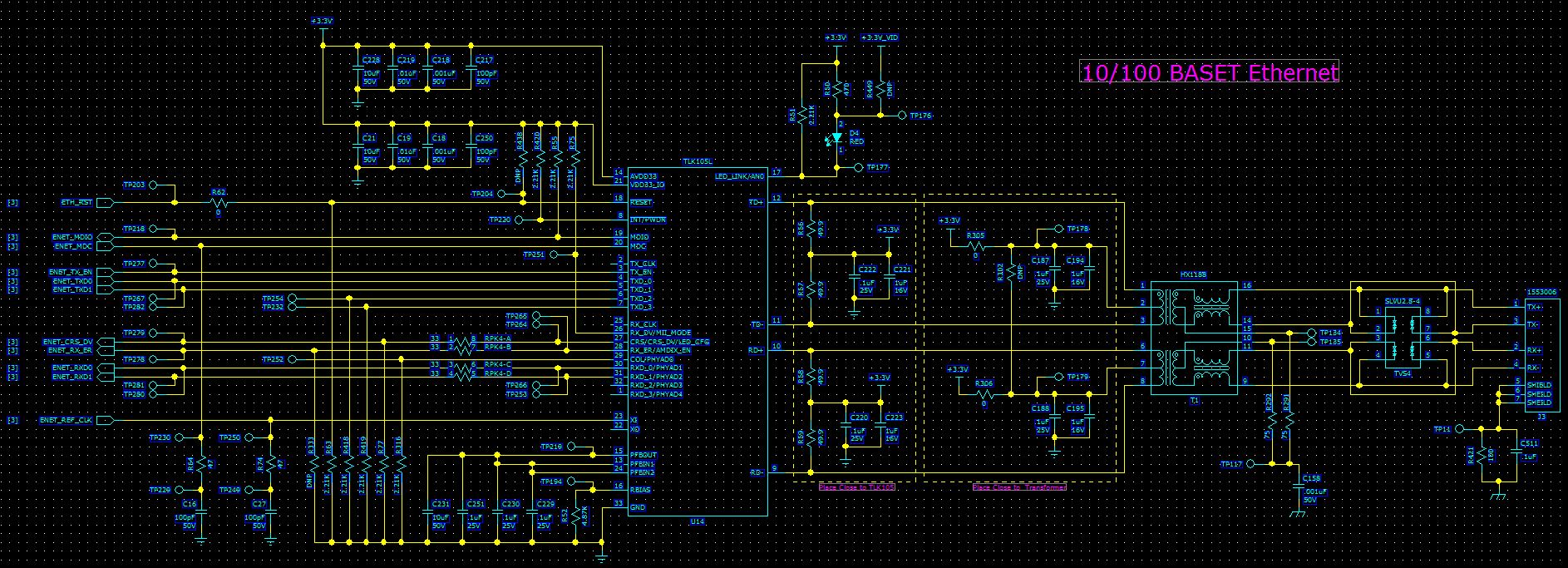

I made some quick screenshots of the schematic and layout since those are usually the first questions. The layout just shows the top layer, but it’s a 10 layer PCB. The connector is an M12 circular industrial Ethernet. As you can see there is a large gap between the plane where the connector is at and the plane the PHY references. At the moment we are trying to make software changes only since the design is frozen. It’s totally fine if the PHY resets and relinks. The trouble is when it gets stuck and requires an entire system reboot to come out of it. It’s really strange that toggling the PHY reset line does not accomplish the same thing as a system reboot in the case of the 2nd failure mode.

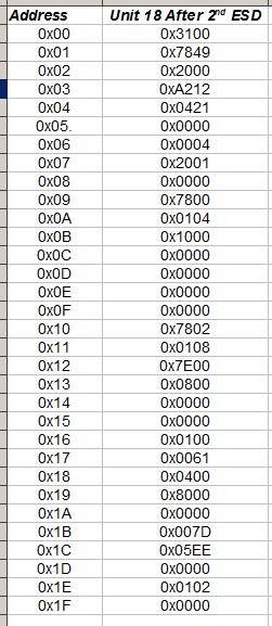

Here are the first 32 registers after the ESD event causes it to get into the 2nd failure mode. I did note some of the reserved registers were not at the default state, if that means anything.

    The functionality you are seeing in the second case is not as clear to me. The toggling between MDI and MDIX modes is a normal part of link establishment when using auto-negotiation. I would expect you to see a similar toggling between MDI and MDIX in the PHYSTS register (address 0x10). I'm not sure why this functionality is not affected by toggling the reset pin. I will look into this.
    In the meantime, could you provide some additional information on the registers that you provided for the second case? Were these captured before or after toggling the reset pin? It would be good to see the registers in both cases. It would be best to provide two consecutive reads of the registers in both cases. Some of the register bits latch their status so a second read will provide a current status.

    In looking at the register information, it does not appear to show the issue of getting stuck in MII mode. The issue now appears to be a matter of establishing link.
    Based register 0x10, the PHY appears to be trying to link in 10M mode. How is the link partner configured in this case? Is it auto-negotiating?
    I see that register 0x1F is set for 0x0040 in some cases. Are you writing to register 0x1F?
    Patrick
  • The register information sent was not intended to show the first failure mode (getting stuck in MII mode). It was to demonstrate the 2nd failure mode where ESD caused it to drop the link and not re-establish, even after toggle of the hardware reset line. The device had to be fully powered off to recover.
    Yes, the PHY is in 10M link mode. The link partner is set to allow all modes, with Auto-negotiation enabled.
    We are not writing to register 0x1F. I had also noticed that it shows 0x0040 in some cases, but since it’s in reserved locations I have no idea what it means.
