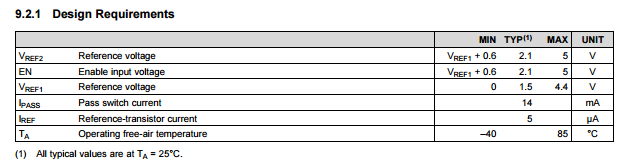

Regarding to the Level shifter of PCA9306, can be used as both type level translation (VREF1<VREF2 ) or (VREF1>VREF2 )?
Thanks.
Hello Passerby,
Thanks for the question.

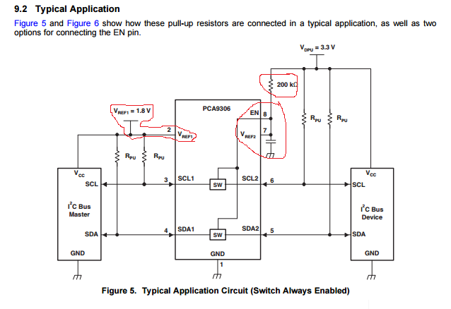

The PCA9306 requires (for translation) that VREF2 >= VREF1 + 0.6 V.
Please see the below images. Also note that the EN and VREF2 pins are shorted together, and then are pulled up to the power rail through the 200k resistor. This is very important for translation to happen.
