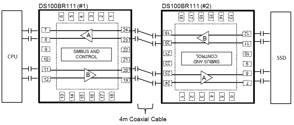

My customer have some questions about DS100BR111.
[Q1]
Is the following connection (Figure 1) possible in SATA II (3G) application ?
(I read "DS100BR111 as a SATA Repeater", so I think it is OK.)
Figure 1 : Connection
[Q2]

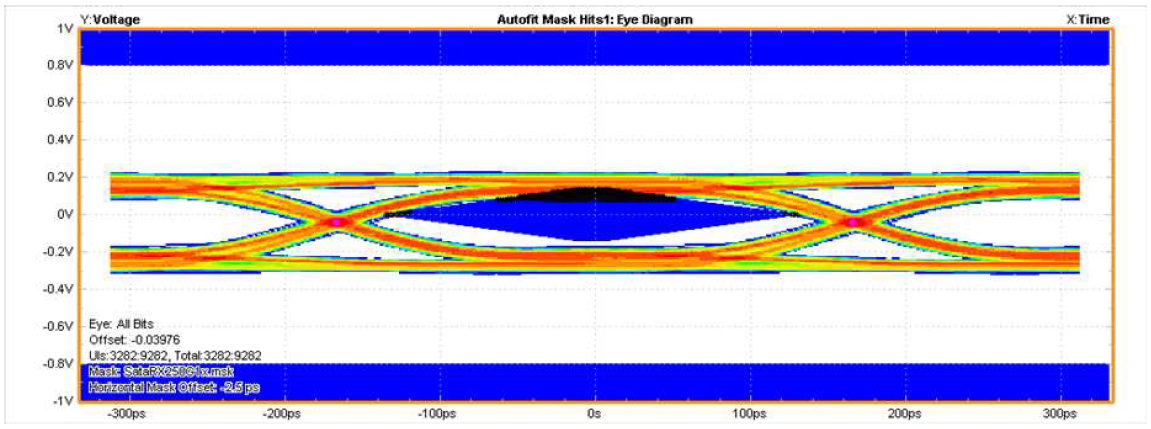

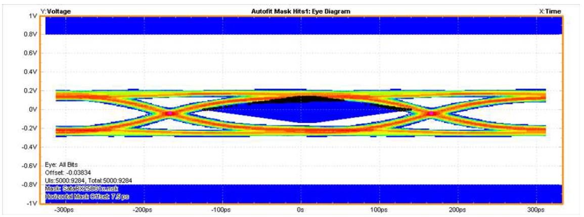

The following figures (Figure 2, Figure 3) are input EYE diagram of DS100BR111.
Are these input levels appropriate?
I think those are appropriate because there are differential signal level more than 190mVpp.
Figure 2 : Input EYE diagram of DS100BR111 (#1) INA+/-
Figure 3 : Input EYE diagram of DS100BR111 (#2) INA+/-

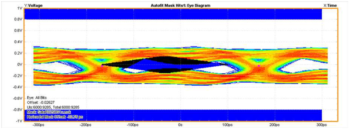

The following figures (Figure 4) are input EYE diagram of CPU.
That seems to be distorted.
Does anything know this cause ? Impedance mismatch ? overkill ?
Do you think it is improved by Equalizer and Emphasis ?
Figure 4 : Input EYE diagram of CPU

  • Hi Hiroshi,
    What are the DS100BR111 settings for CTLE, VOD, and DEM?
    The input signal does not have too much attenuation so I think a minimum amount of CTLE, DEM = 0 dB, and VOD = 700mV should produce a good eye at the CPU.
    It is interesting to see the eye crossing not at 0.0V.  This could be adding to the jitter on the DS100BR111 output.
    Lee
  • Hi Lee,
    Thank you for your fast response.
    1) CTLE, VOD, and DEM values are as follows.
     <DS100BR111(#1/#2) Channel A>
       CTLE = 11.5dB
       VOD = 700mV
       DEM = -3.5dB
     <DS100BR111(#1/#2) Channel B>
       CTLE = 2.5dB
       VOD = 700mV
       DEM = -3.5dB
    2) I'm sorry, your comment is not clear. Please answer prebious [Q1] and [Q2] with "Yes" or "No".
    3) Does following your comment mean setting of Channel A of DS100BR111 (#1) or all ?

  • Hi Hiroshi,
    Please try to use the CTLE = 2.5 dB setting on A as well, this should improve the signal.  Also set the DEM on A = 0 dB.  Keep the settings on CH B as they are right now.
    Lee
