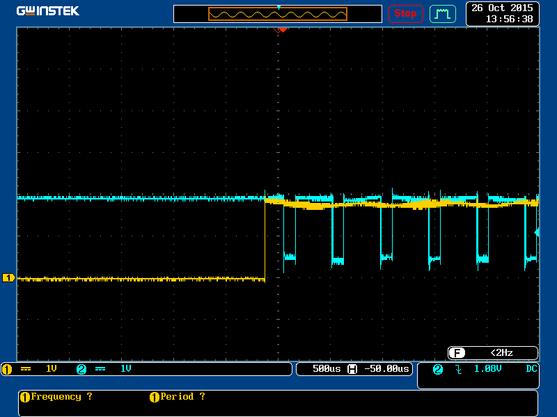

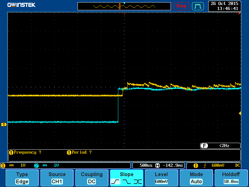

    2) To show the scenario I attach two oscilloscope waveforms:-
    1) First one shows resetb (blue) with VDD1.5 (yellow). VDD1.5 is initially stable at 1.5V before resetb is made high. As resetb goes high, many times it jumps to 2.0V [as here] and sometimes it remains at 1.61V.
    2) Second one shows resetb (yellow) with DIR (blue). As reset goes high DIR come low and starts toggling even if i do not write anything on TXCMD. This toggling happens when VDD15 goes 2.0 V. Else it toggles once and then DIR remains high permanently.

  • DIR Comes low much before 0.534ms. Say around 250uS. What can this imply?

    I'm surprised at the fast rising edges of VDD15. I would have thought your 4.7uF cap would slow them up somewhat. Can you confirm you have used a ceramic capacitor?

    What you are saying, is that despite holding all signals low during apart from applying clock, after reset VDD15 is noisy 100us or so after nReset goes high?
    I'm left wondering how well the power supplies are decoupled and how well the pad underneath the device is connected to ground?
    Anything more and I'm stumped.
