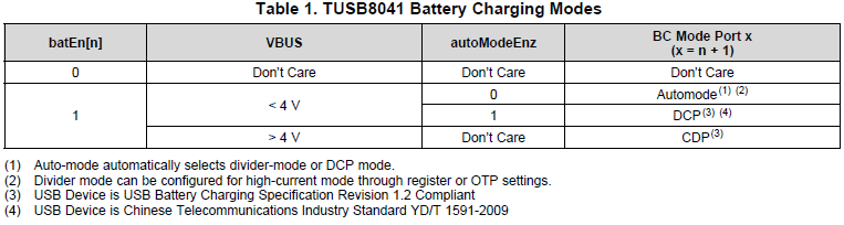

I would like to ask about TIDA-00630.
I believe TUSB8041(USB3.0 Hub) supports battery charging as the following.

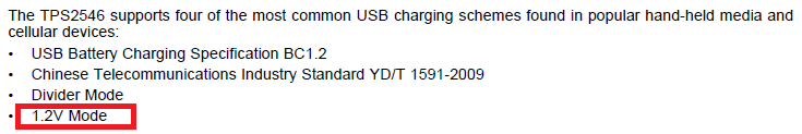

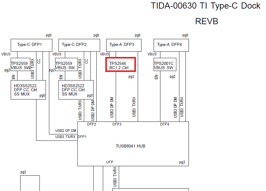

On the other hand, TPS2546 is also mounted with TUSB8041 in TIDA-00630(reference design).
Could you tell me the background why TPS2546 is also used?
Your support would be appreciated.
