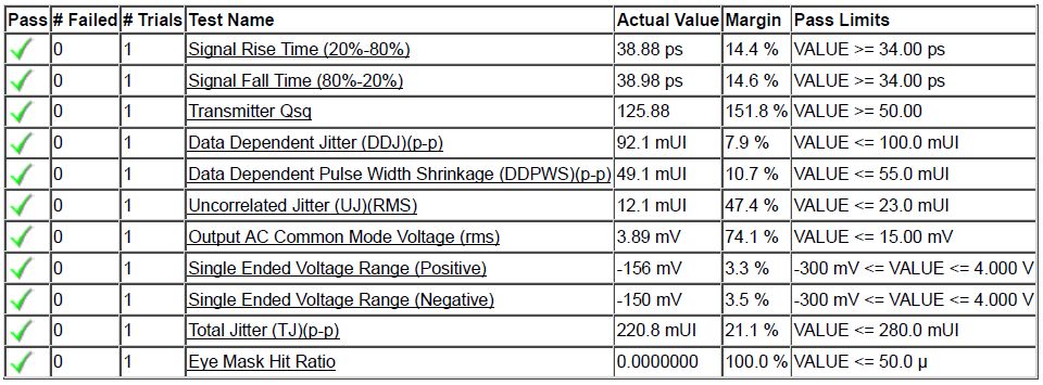

3.  About CPRI 9.8G jitter performance,
    If possible, isn't there following data including DDJ and DDPWS?

    The Tpd is always approximately 1UI + 200ps as shown in the DS125DF111 datasheet.  There is some small total variation +/- 40 ps for process, temperature, and voltage variation.
    The data shown in your table includes DDPWS and DDJ. The DDPWS and DDJ will depend on the exact customer layout.  With clean layout the DDJ can be ~4ps, DDPWS ~2.5ps, and Rj ~400fs giving a Tj ~8ps.
