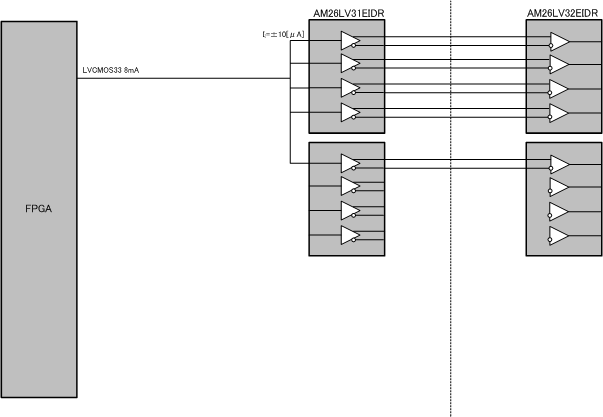

Customer isexamining below composition.
Is there careful point desides input current?
Or, is it no problem?

Satoshi-san,
Other than current input limitations and input voltage specs, the only things to consider are standard differential pair considerations like layout, spacing, and termination.
You should be fine using these devices like this.
