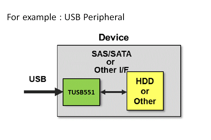

Hi all.
My customer will do USB3.0 compliance test to obtain the USB logo as USB peripheral device.
The content of test is the following,
・ the average suspend current of the device is equal to or less than 2.5mA.
I think that the suspend condition of TUSB551 is "Link in U3"(datasheet P5 Icc-U2U3).
The value is 12.20mA(typ), is this value correct?
I think this device can't pass the compliance test.
Is it recommended that we use the USB redriver in peripheral device.
