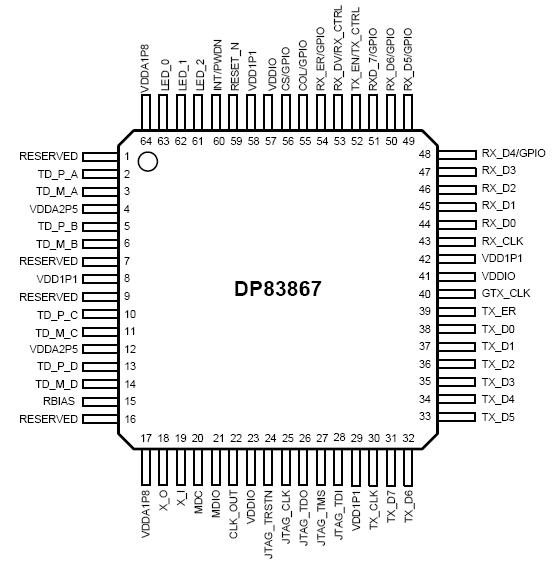

Hola,
Can help provide me the pin assignment of 48VQFN for DP83867IR?Due to it's only 64HTQFP shown in datasheet but I need to know the pin assignment for 48VQFN. Thanks ~

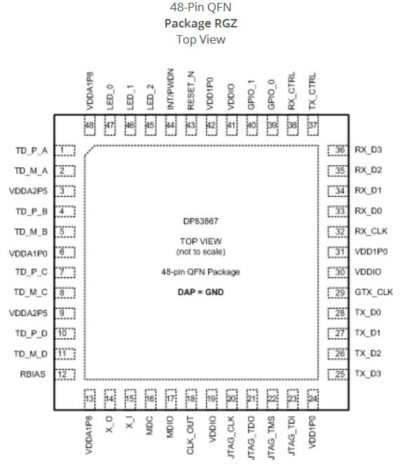

Jacky,
We have just released an updated version of the datasheet that includes the pinout for the 48 QFN package. It is available in the DP83867IR product folder (www.ti.com/product/DP83867IR
Patrick
