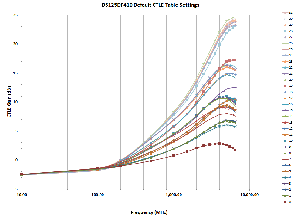

Hi Team,
Our customer is planning to use the DS125DF410 with the data rate 6.25Gbps. What is the programmable maximum gain for 6.25Gbps (3.125GHz) and 2.97Gbps (1.485GHz)? Customer would like to estimate the maximum cable reach for each data rate using this device.
Kawai
