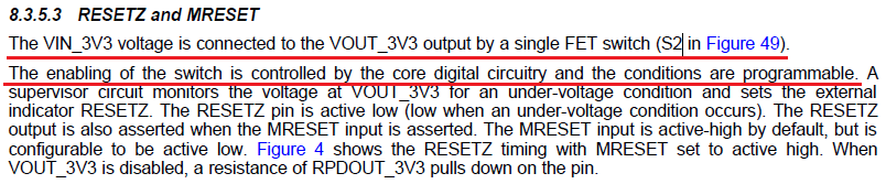

The datasheet shows the following.
(Page.55)
Could you tell me the time delay for VOUT_3V3 after supplying VIN_3V3?
(When does S2 switch become "ON" after supplying VIN_3V3?)
Is there any timing specification?
Yaita / Japan disty
  • May I have your advice?
    Yaita
  • Hi Yaita-san,
    There is not a timing spec for this. Is there a specific issue that needs the timing from VIN_3V3 to VOUT_3V3?
    Jacob
  • Yaita-san,
    Jacob is correct, and it should be noted that the VIN_3V3 to VOUT_3V3 delay is negligible compared to the RESETZ de-assertion timing. This timing is in the 10-100us range. The only reason VOUT_3V3 is shown in the Figure 4 timing instead of VIN_3V3 is because the VOUT_3V3 rail can be disabled by a bit in the TPS6598X-CONFIG Config tool in the "System Configurations" tab. As a result, RESETZ may never be de-asserted, even when VIN_3V3 is valid.
    The default RESETZ de-assertion timing is calculated to be 1.92ms and is configurable up to 163.84ms in the "GPIO" tab of the Config Tool.
