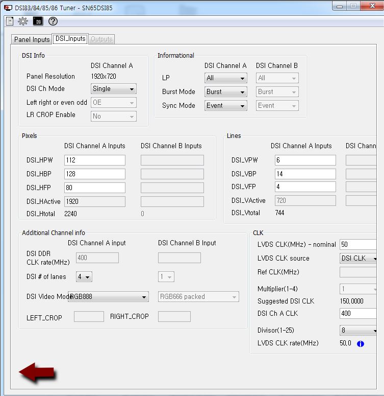

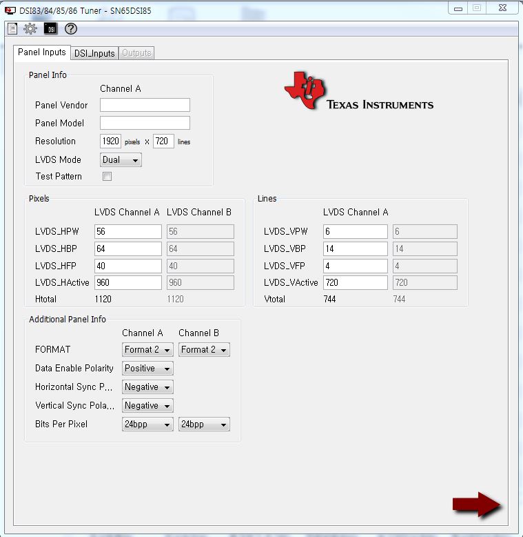

My customer requested me to check their setting of SN65DSI85 device. Below are the system specifications.
  • Resolution : 1920 x 720
  • VBP : 14
  • VFP : 4
  • Vsync : 6
  • HBP : 128
  • HFP : 80
  • Hsync : 112
  • INPUT : MIPI 4 LANE (800Mbps)
  • OUTPUT : DUAL LVDS (50Mhz + 50Mhz)
Below pictures are their settings using DSI tuner.
It looks fine for the numbers but I'm not sure about the other things. Is there anything I need to change or consider? or does it look fine?
