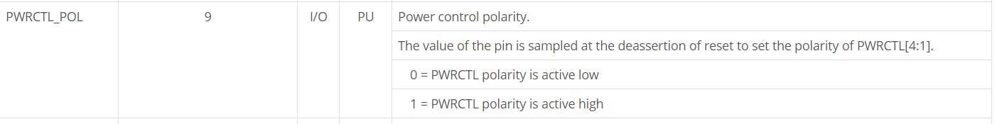

On the TUSB4041I datasheet,
I am confused regarding the PWRCTL_POL pin.  I’m clear on what the settings should be.
On the Pin configuration and Functions table it shows the following:
Pull the pin to ground to set it for active low, and pull the pin high for active high configuration.  This seems clear, however in the Application and Implementation section it shows the following:
The design example seems to continue with this implementation by pulling the pin to 3.3V through a resistor.  Which is correct?
