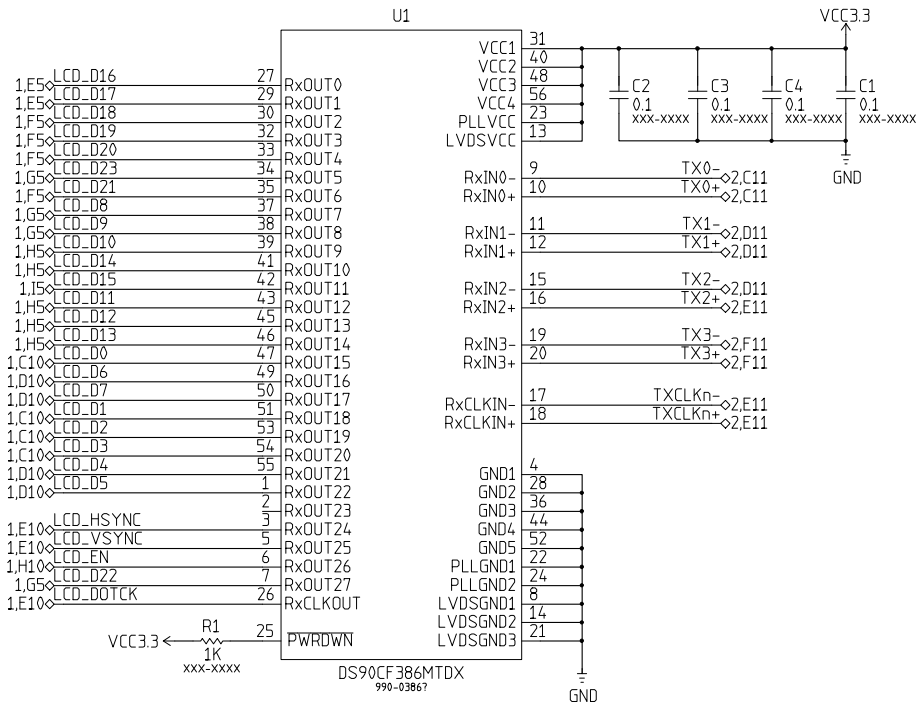

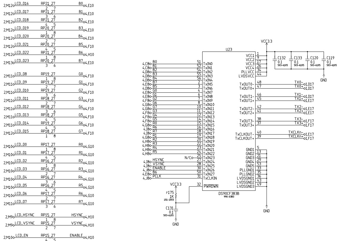

I have a product that was driving a display directly through an RGB type connection, the system architecture has changed requiring the use of LVDS across a cable (12" long) to the display. I am using a DS90CF383B LVDS Transmitter connected to a DS90CF386MTDX Receiver which I am attempting to run with a TxCLKIN at 19Mhz.  What I see on the display is unrecognizable "moving fuzz".

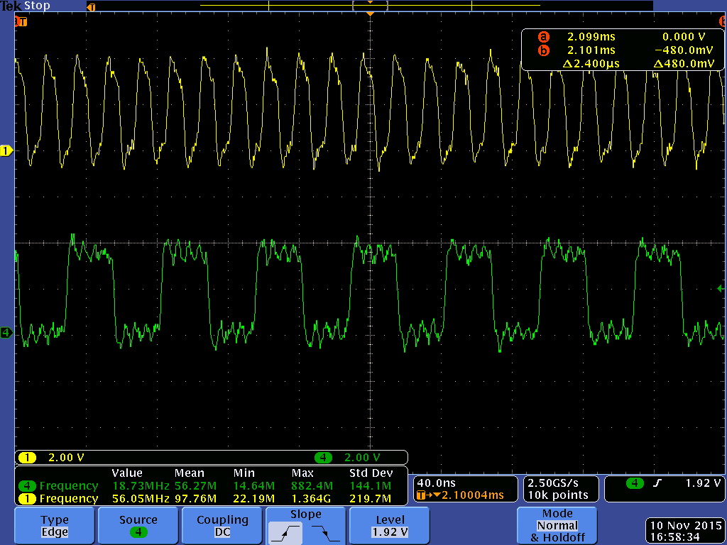

To troubleshoot this I've confirmed that the cable pin out is correct between the two controllers.  I noticed that while I'm inputting a Dot Clock (TxCLKIN) of 19MHz, I'm getting out a Dot Clock of 56MHz out of the receiver....  Additionally the TXCLK+/- signal appears to be running at 19MHz.  I believe this differential clock should be an order of magnitude 7 times higher then my TxCLKIN to transmit all 24 bits of color data.  It looks like the internal PLL is not locking for some reason.
Could someone provide me some with some assistance to help guide my debugging?
Mark
TX Schematic
RX Schematic
  • Here is the scope trace of the RX dot clock (yellow) and the TX dot clock (green)
  • Hi Mark,
    I believe your problem could be coming from two different sources.
    First, the DS90CF386 LVDS receiver supports a 20 MHz – 85 MHz shift clock. Your clock is outside of this range at 19 MHz.
    Second, each LVDS input and output must have a 100 Ω termination. This resistor terminates the differential lines with their characteristic impedance. This termination resistor is necessary in order to probe and measure LVDS signaling. Without the 100 Ω differential termination, you are creating an open circuit, and the signals could be distorted.
    Katelyn
  • Hi Mark,
    As an addition to Katelyn's response, the LVDS clock output from TXCLKOUT should be at the same frequency of TXCLKIN. When the LVDS clock is received by the LVDS deserializer chip, the internal PLL onthe Rx will scale up the clock x 7 and sample the incoming LVDS data signals according to the Rx strobe positions for each bit in the LVDS clock cycle. If the incoming clock is out of the LVDS receiver lock range, as Katelyn mentioned, the receiver may not be able to lock.

    Thank you for your responses!  I've added 100 ohm terminations and am now seeing the same dotclock output from the RX chip as is being input to the TX chip.  We have also bumped the clock up to 26MHz for testing purposes as well.   The display looks closer to what I would expect but its still not quite right, I am in the process of comparing all of the data lines on the TX and RX side to find out which is the culprit.
