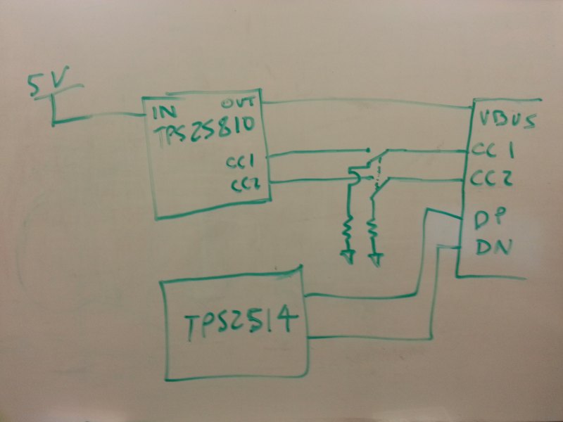

we want to use the TPS2549-Q1 device for our new design. We have two main features
1. load a device (Handy, Tablet,...) via USB
2. communicate with the microcontroller
Due to space issues we have to share one USB connector, so we can either loading or communicating.
So the general structure of the application is similar to a power bank with the additional requirement, that we have to provide a data path to a microcontroller.
The question:
We have to switch the TPS2549 either into "Device Mode" or in one of the "Load Modes" manually via the control pins.
What happens if we switch into "DCP-Mode" but connect an USP-Host Port (like a PC). In this situation i expect that we (TPS2549) drive 5V and the connected Host port also drives 5V. Is there any protection?
Is there any possibility to automatically detect and distinguish between connected Host (for communication) or device (for loading)?
Do you have any other/additional product to make such a decision automatically?
Thanks for Help
Thomas
  • The TPS2549 has built in current limit and thermal protection so it would be protected against a connection to another host that was also supplying 5V. A better question is will the host have the same protection? The TPS2549 also supports a client mode which will turn off the internal power switch while still having the DP and DM connected. You would have to put the device into client mode prior to connecting the host for programming. I'm not sure how you could get a host to automatically put the TPS2549 into client mode without some kind of sideband signal. USB Type-C with PD could solve these problems by making your device a DRP (dual role port) device.

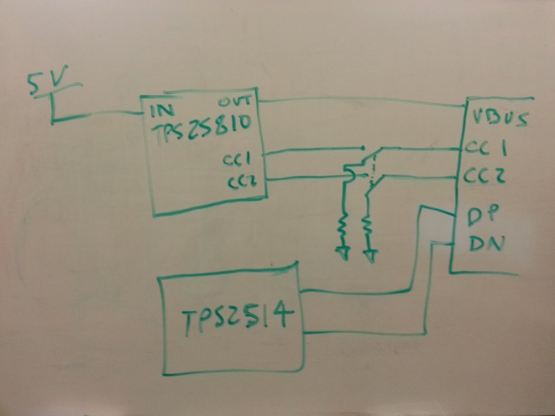

  • You can learn more about type-C here http://www.usb.org/developers/usbtypec/
    download the USB 3.1 specification zip file. Inside you will find the specs for type-C and USB PD (Power delivery). You can also do a web search for "USB type-C" and you will find a lot of general info on how it works.
    Something like this might work except replace the DPDT switch with a FET circuit that can decide when the port should behave as a DFP (host) vs UFP (device for loading software). The type-C connector is shown on the right side of the picture.
  • Hi Lee,
    thanks. It answeres my question. I found already the TPS25810 and red the datasheet.
    I think this is the correct solution. I will discuss it with my Colleges.
