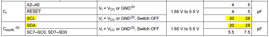

    So if you look at the TCA9548A, it shows several specs for capacitance. For this part, would I add the SCL and SDA capacitance for a total capacitance of ~24 pF + ~24 pF = ~48 pF
    Thanks!
    Jared
  • Jared,
    You are partially correct.
    Because each SDA and SCL line are technically independant (and get their own pull up resistors), you will treat each one as a separate bus. Normally, these two busses will have almost identical capacitance and will allow you to just re use your resistor values.
    In this case, you would assume that the device contributes ~24 (I would assume 28 to give myself headroom)pF to a bus (SDA and SCL are two independent wires/nets).
