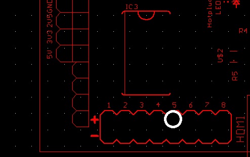

  • There should be no problem running it without 5V connected. It looks like the 5V_SUPPLY pin is connected to a connector (white circle shown below). It's likely that ESD (or maybe the cable was charged and discharged upon connect) damaged the TPD12S520 when that cable was attached, as the 5V_SUPPLY pin is not intended to be connected to an ESD source. That pin, and LV_SUPPLY, CE_REMOTE_IN, DDC_CLK_IN, DDC_DAT_IN, and HOTPLUG_DET_IN are only rated +/- 2-kV ESD.

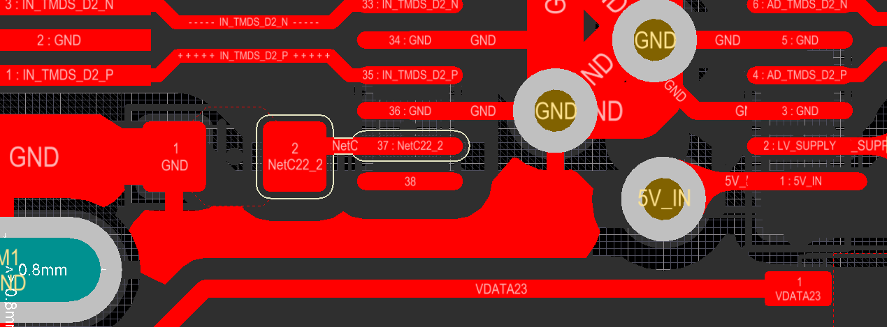

  • Got another couple of TPD ESD chips, are the 'straight-through' pins on the TSSOP38 supposed to be connected on the pcb ? The chip itself should conduct through them, right ?
    Because this is what my pcb is: images.sshnuke.net/2015-12-14_21-55-28.png
  • Also, the first time i powered up a newly soldered TPD, ESD_BYP is now directly connected to 5V_IN, on the spare new one i have it behaves like a diode.

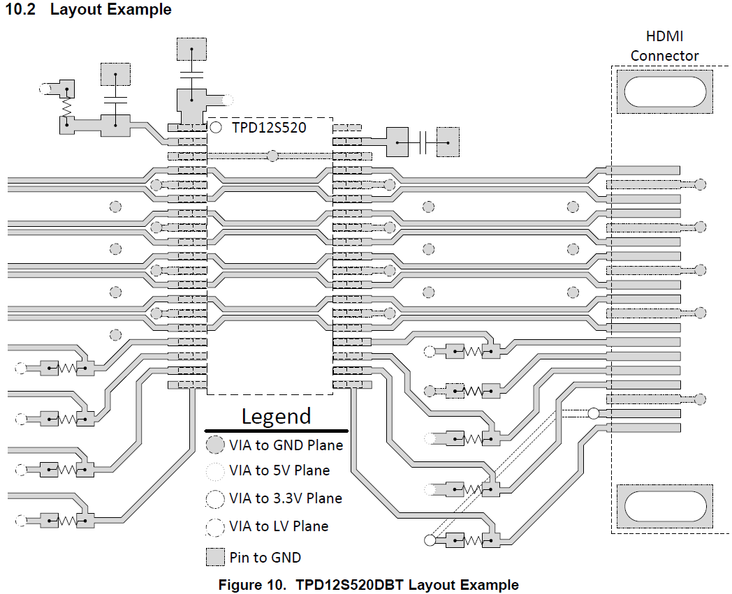

  • Please follow the layout guide from the data sheet:
    The data lines route underneath the device. In your layout they do not.
    Regarding the behavior between the ESD_BYP pin and 5V_SUPPLY on-board and off, where on-board they are shorted and off-board the diode is visible between them, I would want to know if there is any resistance between the board's ESD_BYP and 5V_SUPPLY pins on an unpopulated board as your description indicates there is not.
  • No, my ESD_BYP is there only for the capacitor: images.sshnuke.net/2015-12-15_20-48-19.png
    I'm asking since the first time i powered the board up, that measured 4.3V, now it measures 5.3 and is 0ohm to 5V_supply. Did it somehow break even though i never connected anything to the hdmi port ?
    So, if the 2 data pins opposite each other are not connected... why does the pdf give them the same net name :( These boards are useless now, i would have to solder mini bodge wires across the chip to get hdmi going. In other ESD products, the pdf clearly says the 'output pin' is NC, like this: www.semtech.com/.../rclamp0522p_0524p.pdf

  • Sorry about your board. In the Pin Description we clearly note for any pin named TMDS_D2+ (for example) these two pins must be connected together inline on the PCB. We also show this in the layout example.
    Can I know what is the resistance between the unpopulated board's SMD pads for ESD_BYP and 5V_SUPPLY?
