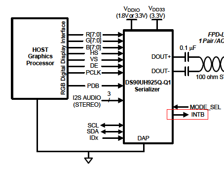

Because I use DS90UH925Q and DS90UH928Q on system, I have two questions about their application.
1. As below application, Does interrupt function is connect?
Does the DS90UH925Q's 0XC6 registor can read DS90UH928Q's INTB_IN?
2. If we don't have MCU on sink side, can we get DS90UH928Q INT signal from host processor?
If is can't, could you provide other solutions with me?
