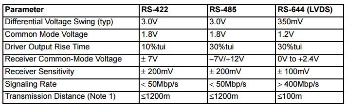

  • Hi Tom,
    To clarify, only TIA/EIA-644 is considered LVDS (which is also slightly different from standards defining M-LVDS and B-LVDS). RS-422 and RS-485 in themselves are other interface standards for high-speed signaling rates. You are correct that RS422 has a larger allowable ground potential difference, but it is also not equipped to handle the data rates that the LVDS interface is capable of.
    I found a document comparing RS-422/RS-485/LVDS in an application note from Fairchild that is pretty insightful regarding differences in signaling amplitude and common mode voltage range:
    Michael
