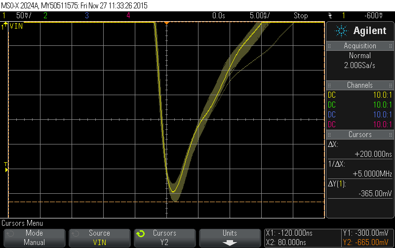

We are using the USB of TM4C129CNCPDT microcontroller in full speed mode. At end of packet (EOP) signalization we have voltage spikes at data lines over common I/O  limit (300mV).
Despite it, this interface is made to interface directly USB devices and maybe it can withstand harder limits than common I/O limit.
Does microcontroller USB data lines have differentiated limits than common I/O? If yes, where can I find it?
