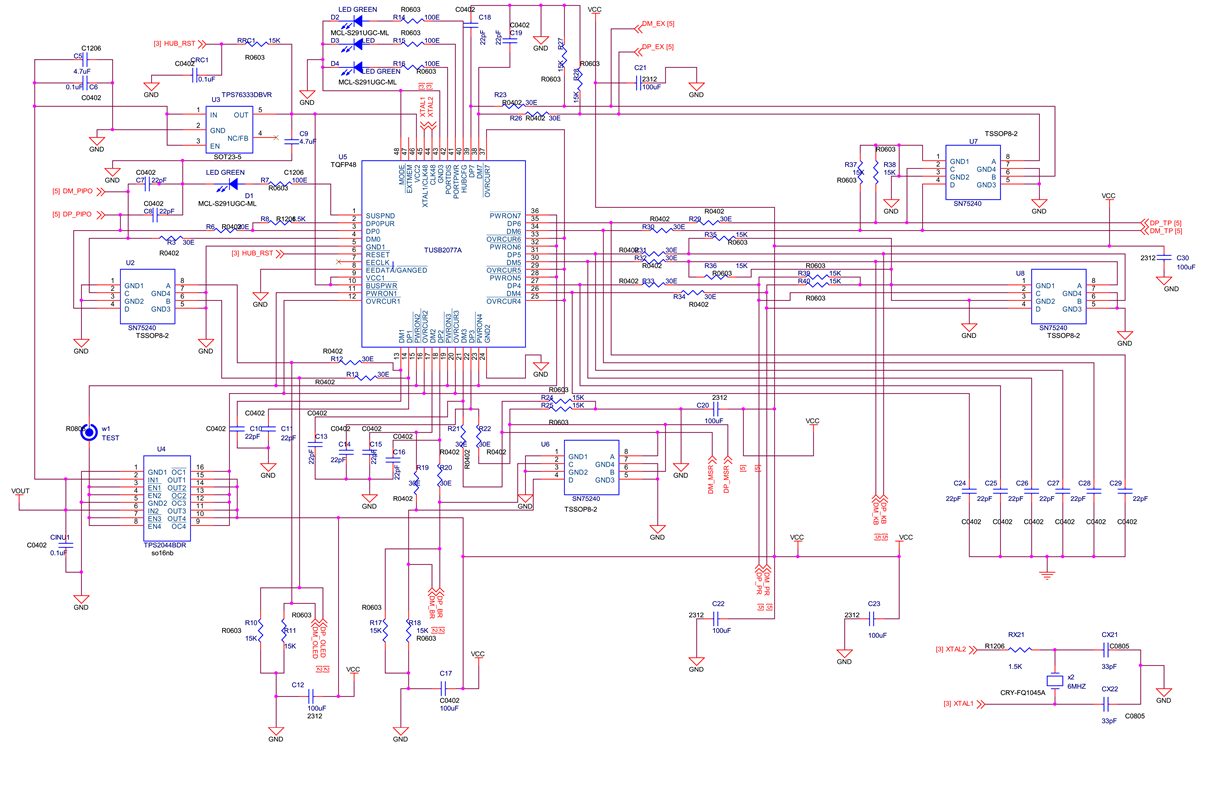

          I have used TUSB2077a to construct a self powered, ganged power management device. The had some issues in device enumeration but got it solved from your support team. The problem I'm facing now is that the device in the Downstream port a HID Keyboard device is connected to port 5 of TUSB but doesn't get detected in the PC. when I use other ready-available USB hubs in the market the same device gets detected.

    After double-checking your schematics, and I noticed that the EXTMEM\ pin is left unconnected, please connect this terminal to Vcc.
    Are you able to send me your schematics with values in the passive components?
    I have used the same values for Passive components as proposed in datasheet of TUSB2077A. After your 1st suggestion I have connected EXTMEM pin to Vcc (3.3V) and only then the device was enumerated with ids in the PC. But the downstream devices are not detected when plugged-in. Would this data help to debug?. I feel the Device is not fully configured is my doubt right?!

    Sorry, I missed this thread. Please, share your schematics.
  • Hi Joel,
    Please find the schematics.
    DanishUSB_Patch_Panel.pdf
  • Hello Danish,
    I cannot see the pull-ups in the OVRCUR terminals. TheTUSB2077A does not have internal pull-up resistors on the OVRCUR/ inputs and these are required (unless the power switch has them implemented internally).
  • Thank you so much joel. I Pulled up Ovrcur lines with 15K resistor and ports started working. Again thanks for ur help!!!!
