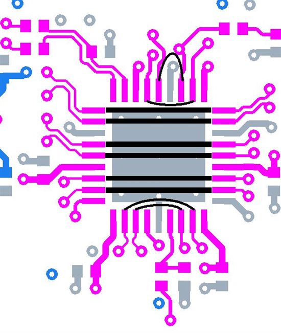

    Yes, the DP connector is through-hole. Moving the traces on the opposite side of the connector will still leave some stub. Do you have any other suggestion to improve the SI? Maybe adding a damping resistor or termination..or anything else that you know.

  • I have tried removing the DP120 and wire the connection as in the attached picture. The signals I captured is way much better than with DP120.
