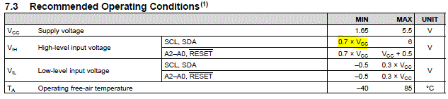

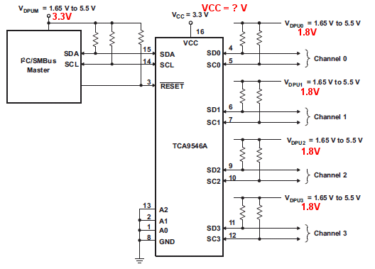

We are supporting Quanta to design a 3.3V to 1.8V I2C level shifter with MUX as the following block diagram (project name: S1U):
According to the datasheet, it requires at least 5V for 3.3V Vpass:
However, the VIH(min) of the SDA and SCL is 0.7VCC = 3.5V, which is not compatible with 3.3V I2C on the left.
Would you pls advise how to calculate the inimum VCC requirement in this case?
