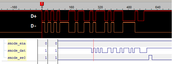

  • Hi, Gerardo!
    Nevertheless I tried to enable SerialMode in TUSB1310A. And it works!
    I successfully entered this mode and received data in LS and FS modes.
    I also tried to transmit data just by toggling the line. It is ok too.
    Here is a diagram of data reception in FS mode. (SOF packet)
    (Top diagram is actual data at the USB D+ and D- lines of the PHY. Bottom diagram is data from PHY over ULPI)
    Looks like both 6-pin and 3-pin LsFsSerialMode are supported. (In my application I used 3-pin mode)
    I really think that there a mistake in the last datasheet. What do you think about that?
    Best regards
  • Hello VG,
    Sorry for the misunderstanding. let me check with the design team.
    Gerardo
