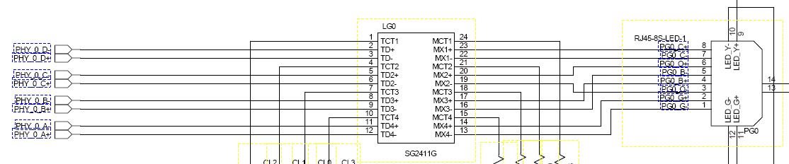

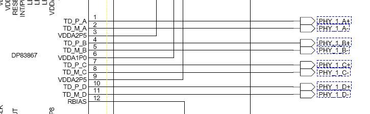

  • Hola Rob,
    Can help confirm below items description whether it has any problem?Thank you very so much.
    1. The terminal resistor that we will place it as DNP and according to the description that we can turn on the FPGA PAD's inherent resistance(input 25/50/75 ohm、output 50 ohm) and it will get the best response by trace of length 6mil、interval 12mil.
    2. PHY address = 0;we connected all of LED to the ground and if the current low as define value and it will assumed mode 0.
    3. Reset/XI are setting by FPGA, if we not set the basic function by MDIO and we can set the basic parameter after reset by FPGA I/O (mode 3/0).
    4. Below connection whether it has problem?PHY's output A/B/C/D connect to G/B/O/C. (Coffee C / Blue B / Orange O / Green G;trace of length 5mil、interval 5mil)

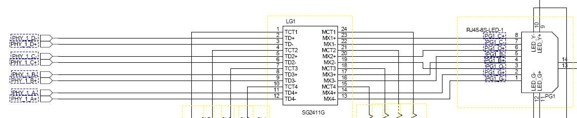

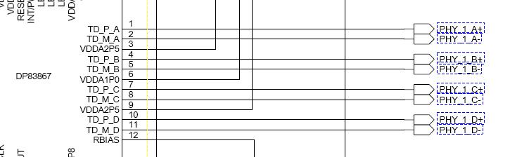

  • Hola Rob,

  • Hi Jacky,
    1. Yes you can DNP the termination resistor and choose the 50 ohm input/output impedance for your FPGA.
    Does the trace length refer to the width? You will have to do the calculations for the trace impedance to match 50 ohm single-ended.
    2. It is not recommended to connect the pins directly to ground, if that is what you mean. For LEDs, follow figure 18 in the datasheet for mode 1(0).
    3. Yes, after reset by FPGA, all strap modes will be resampled. You can set the parameters by MDIO after a reset as well. PHY address can NOT be set by MDIO.
    4. From the schematic I see PHY output channel A connected to Green, channel B connected to Orange, channel C connected to Blue, channel D connected to Coffee. This is the correct pinout.
    Are you seeing a problem with a board or is this in the schematic phase?

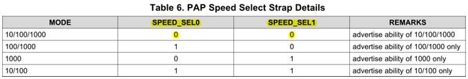

  • Hola Rob,
    About question 2 that I want to confirm with you as below:
    1. Let SPEED_SEL = 0、PHY_ADD[3:0] = 0.
    2. DP83867IR/CR(48pin):Quote Figure 22.(Strap Circuit = 0) & Figure 23. & Table 5.(4-Level Strap Pins), and we got SPEED_SEL = 0、PHY_ADD[3:0] = 0.
    3. After reset and it can support 10/100/1000, and MIDO(PHY) address = 0.
    About Figure 18. --> I think it unable to establish because of it only has RGMII interface with 48pin and has no CRS/COL..

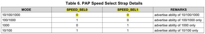

  • Hola Rob,

  • Hi Jacky,
    Sorry for the delay. The email alerts for thread updates aren't doing well.
    Correct, table 6 applies only to DP83867IR. DP83867IR has SPEED_SEL0 and SPEED_SEL1 bits.
    Table 7 applies to DP83867CR. DP83867CR only has SPEED_SEL bit on pin.
    You are correct to interpret the straps in the way you have
    Figure 18 applies only to DP83867IR. Only that device supports MII mode and has CRS pin. In the beginning of MII section, it says MII is only available for PAP(DP83867IR) devices.
