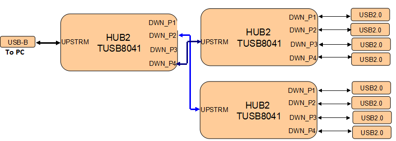

  • Hi
    if I cascade TUSB8041 as shown in the attachment, assuming that all the device connected transfer data in transparent mode (data in speed equals to data out speed) then how much throughput on each interface can in expect in these case.(all the devices and hubs are operating in USB2.0 Interface)
    Unfortunately this only have theoretical answers, as the downstream devices are High-Speed, the bandwidth will be dictated by the Host controller, the TUSB8041's will not decrease the bandwidth.
    The USB Host will assign bandwidth based on the endpoint type and bandwidth requirements of each downstream device, assuming all the downstream devices are exactly the same and all the downstream devices are doing the same exact transaction then you could expect the bandwidth to be equally divided by the number of downstream devices.
