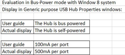

In TPS2071EVM-159's user guide, the test environment is indicated as Windows 98 and Windows 2000. As we know, the popular version of windows is Windows 7 onward, So I use Windows 8 to do evaluation.
When I do evaluation refer to its user guide (SLVU037, september 2000), found below mismatch in its Hub information which display in USB Hub properties:
Please advise what's happen to this kind of mismatch, actually I use TUSB2046B in my design, and the TPS2071EVM-159 board with TUSB2046 is only the one EVM similar to TUSB2046B. So that I need you advise that is it the same phenomenon between TUSB2046 and TUSB2046B ?
