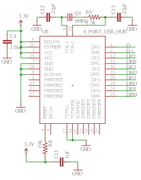

Layout of the TUSB2046B
Hello - i am designing a schematic and want to make sure i have the RESET pin configured in an operation manner. Would this configuration work to properly reset the device and enable normal operation? Also, do i need to connect any of the PWRON or OVRCUR pins if i do not intend to draw any power from the device (only using an external power supply)?
Thanks for your help!
