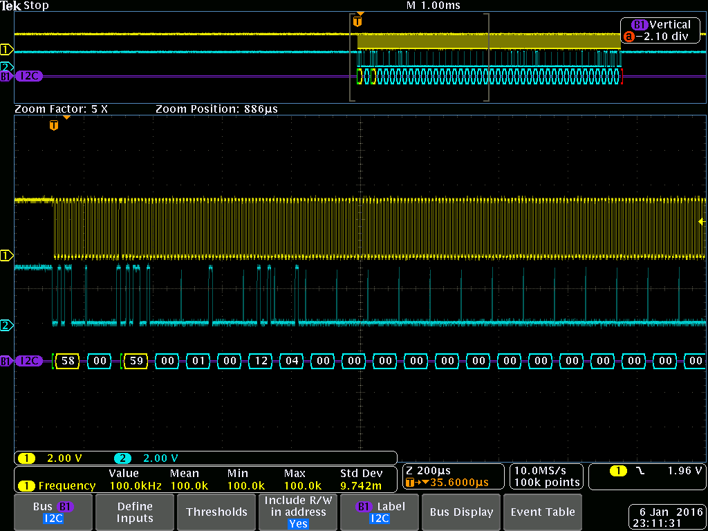

We're using SN75DP130SS for a project. Instead of using it in GPIO-driven mode, we are doing some settings on it via I2C. The schematic was previously posted by this account in a separate thread. The hardware has now been tested and works correctly. DP link amplification is confirmed, and the IC is drawing ~130mA in 4 lane HBR mode.
Writes are working correctly (confirmed by using power off and other functions), but reads are strange.
This device doesn't have subaddressing, and datasheet says it will just return all registers from offset zero until host returns NAK. This is all fine and well. So we setup a simple read transaction on the host:
0x59(R) RD RD RD RD ... 39 times STOP.

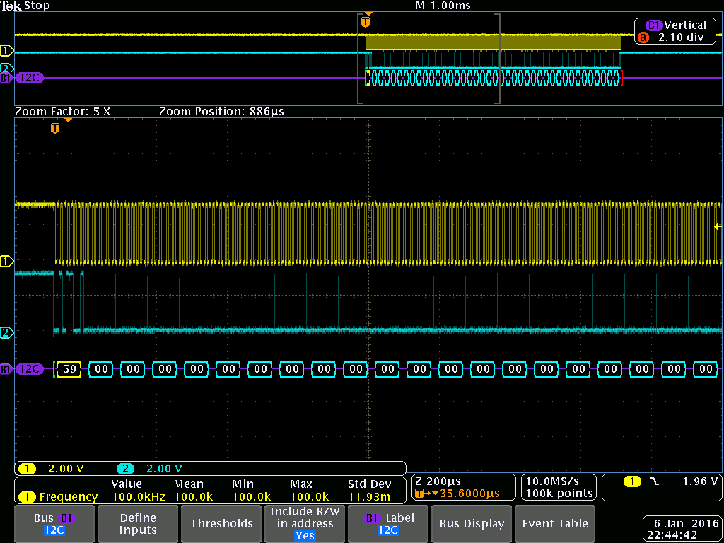

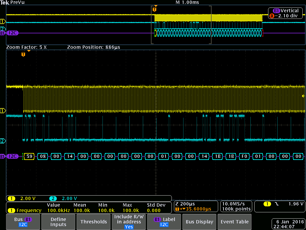

On first read, we get 0x08, 0x00, 0x14, 0x00, 0x00.... etc
If we then go and read again, we just get 0x00, 0x00, 0x00.... until end of read.
IC is rated at 100kHz I2C and that's what we're using.
Datasheet page 25 "read the SN75 I2C registers" procedure is followed.
How can we get consistent reads out of the device?

  • Yes, it works, and reads are consistent.
    Why? Does that mean we *can* actually use subaddressing?
  • Hi Hamasaki,
    It seems you need to use subaddressing because the register address counter is not resetting.
    I have to report this.
  • Well, that makes sense.
    Also looking at the 1st post again, the 1st screenshot reads returned were actually starting from register 0x17 (this is where things were written last, before reads). So it seems subaddressing does exist and/or work, or at least subaddress counter is kept during writes.
    So if possible, can you check into this and get an official confirmation from hardware people that this will work in any revision/datecode of this IC, etc?
    If subaddressing can be used it would actually help a lot because we need to read some DPCD registers and re-reading 40+ registers each time is annoying, but this would need to be always available and not hardware revision dependent.
    EDIT: and if this is official/supported by all hardware revisions, perhaps datasheet needs to be amended?
  • Hi Hamasaki,
    It seems sub-addressing should be supported in all hardware revisions.
    Datasheet will be amended, there is not an ETA for the change.
