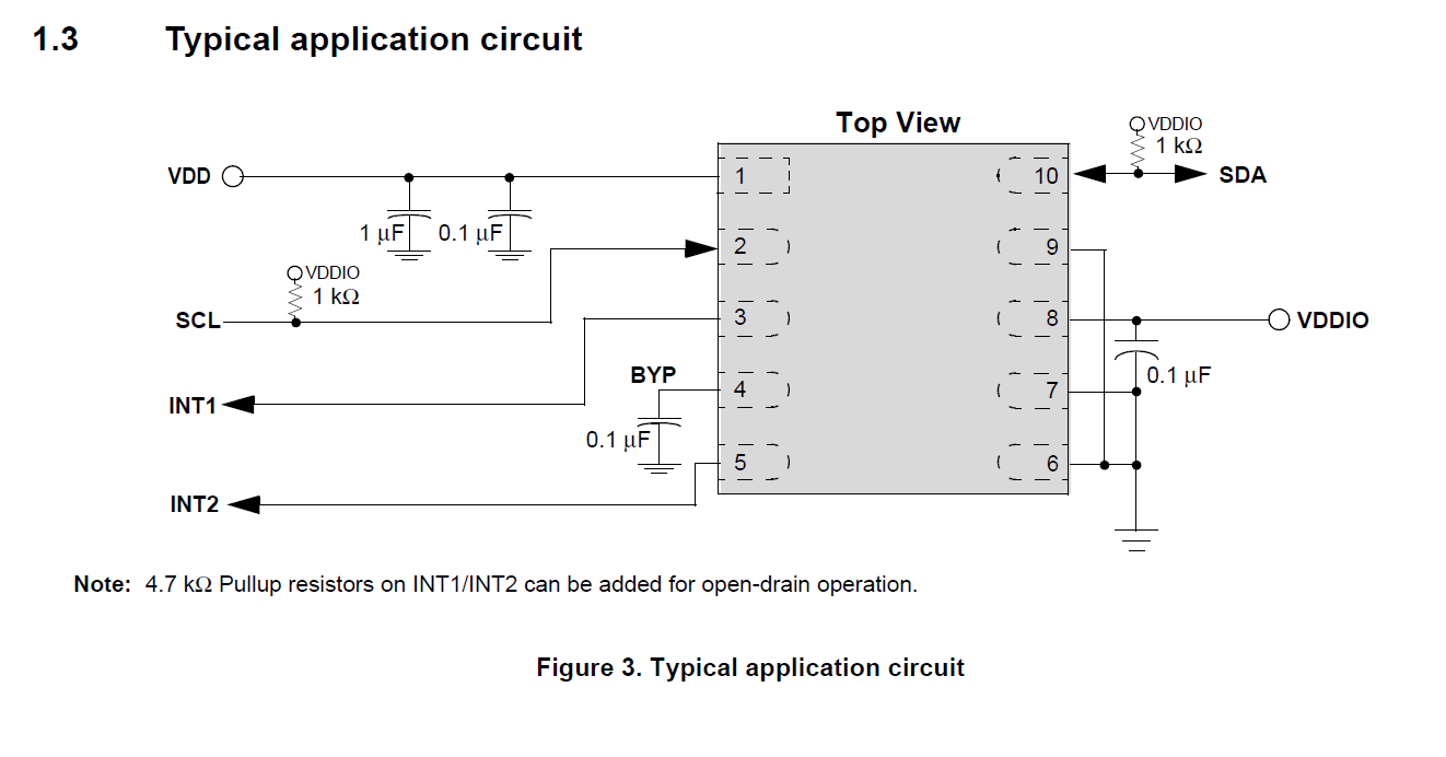

    Also, could you supply a block diagram/schematic showing your I2C bus. I am interested in your I2C devices connection to the bus and pull-up resistors.

    Here in attachment a typical application circuit used for our MMA865X.

  • The MMA865X works as expected with standard electrical configuration when it is the only device on the bus. It was an address issue there. It still does not work in the other test case but I do not care about it. Problem solved.
