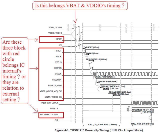

Hola,
I have a question about TUSB1210 application as below:
1. What the conditions the REFCLK & HS mode will be used?
2. Our power sequence is as below:
Thank you

As you suggest, I took those signal to be internal and so of little interest to a user.
What is "REFCLK & HS mode"?
Hello Jacky,
The blocks with red mark are internal signals.
REFCLK is an optional reference clock input pin.
If the Link is going to provide the reference clock (through pin #26, CLOCK) then REFCLK pin must be tied to GND. If a square-wave reference clock is provided to the REFCLK pin, then the CLOCK pin will be an output. Both modes are the INPUT and OUTPUT, respectively.
