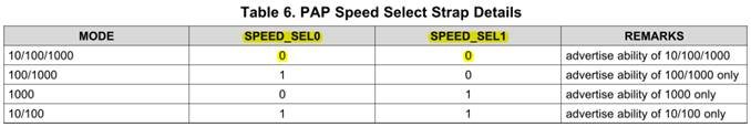

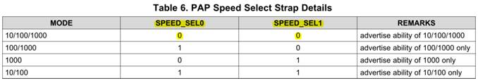

1. Let SPEED_SEL = 0、PHY_ADD[3:0] = 0.
2. DP83867IR/CR(48pin):Quote Figure 22.(Strap Circuit = 0) & Figure 23. & Table 5.(4-Level Strap Pins), and we got SPEED_SEL = 0、PHY_ADD[3:0] = 0.
3. After reset and it can support 10/100/1000, and MIDO(PHY) address = 0.

  • Hello Jacky,
    My apologies for the delayed response. In the beginning of your post, you refer to a previous conversation about LED pin being in Mode 1. It is correct, we recommend to NOT connect the LED pins directly to ground. However, we have revised the datasheet and the figure numbers might have changed. Please refer to figure titled "Example Strap Connection" for Mode 1 LED connections.
    I would also like to add a clarification that the datasheet includes 3 devices with certain distinguishing factors.
    DP83867IR-PAP: 64 pin QFP Package (MII, GMII, RGMII)
    DP83867IR-RGZ: 48 pin QFN Package (RGMII only)
    DP83867CR-RGZ: 48 pin QFN Package (RGMII only)
    In your question, I can see that you refer to the 48pin RGZ devices. The RGZ device support the SPEED_SEL0 strap only, SPEED_SEL1 is not supported. Please refer to the "RGZ Speed Select Strap Details" Table.
    SPEED_SEL0 will advertise 10/100/1000 mode, so what you observe is correct. Figure 18 is MII connections diagram and its not supported by the 48 pin RGZ devices.
    Hope this helps!
