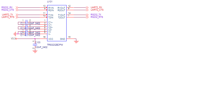

             he schematics of customer is as below.
Condition : PC RS232-TX to pin13 RIN1 ->pin12 ROUT1 to MCU UART-RX
                                              ±10V                   ->                   0~3.3V inverting signal
After long time test
      The voltage is changed to 3.3V             ->                    3.3V non-inverting signal and function abnormal.
                  What is the issue root cause for above phenomenon? Thank you.
