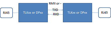

Are there any TI Ethernet PHY supporting Reater Mode( Back-to-Back) ?
My customer wants to cofigure in Single Ethernet PHY x 2.

Hello Taka,
Yes, DP83848 supports back to back communications in RMII mode. The back to back operation is explained in this app note: http://www.ti.com/lit/an/snla076a/snla076a.pdf

My customer is currently considering a TLK110. It has been used successfully into their company.
Are TLK110 x 2 supporting for Back to Back communications?
If no, can they configure in TLK110 and DP 83848 for back to back mode?
Taka

For back-to-back configuration,
Do we need any special register or strap configuration? I think it must be configured in RMII mode by boot strap. Is there anything else?
You mean that TLKXXX are not recommended for customer's new product. Is this correct?
