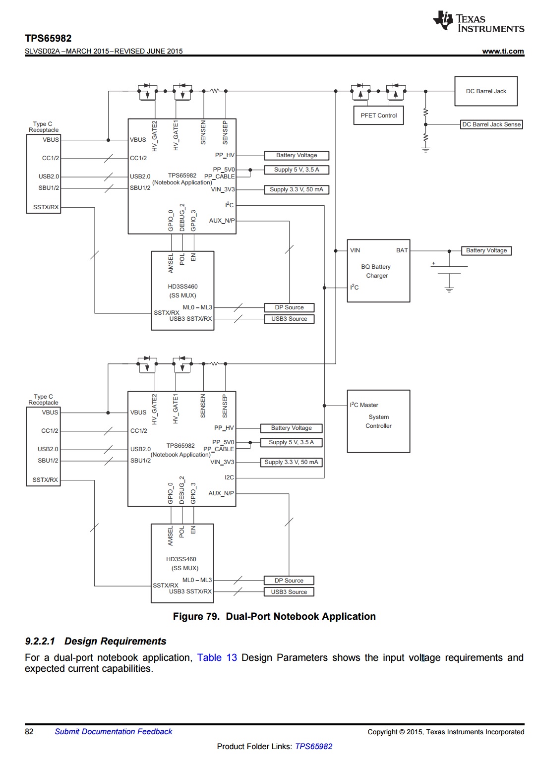

Team,
I'm planning on using the following block diagram from the TPS65982 Datasheet for DisplayPort output with USB-C connector. If I'm not planning on using the USB 3.0, is the HD3SS460 MUX needed for any reason?
Hi Benjamin,
If this is a captive cable design then you do not need the HD3SS460 (SS MUX) since the DP signal orientation will always be known. If it is not a captive cable design you will need to properly mux the DisplayPort signals with the HD3SS460.
Karl
