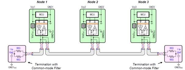

I am using an ISO1050 for CAN bus. I found some Stuff error when CAN running. when we done troubleshooting we found that its RX pin goes low for some time (variable time 10Us~20uS). for this test we shorted pin 1,8 and  pin 4,5 and give 5V from an external power supply. we disconnect the trans-receiver from microcontroller so that it can not receive any data. we put 60 Ohm termination on CANH and CANL pin and TXD pin is pulledup using 1K resistor.
Plz suggest wat could pull that pin to low, when both input and output of that pin is not connected.

    We are using DUB package of ISO1050. this phenomena is repetable, as per our understanding this IC is pickup some ground noise as this IC and controller ground is  same. for this we install a Common mode chock in CANL and CANH path, errors reduced but didnt eliminate.
    we put commond mode in our power supply path, but error increased. so plz suggest how to reduce that ground pickup??

    Please add the below circuitry for filtering common-mode and differential noise.
    1. Please also add differential filter on CANH and CANL lines. 10Ω resistor and 330pF capacitor, the capacitor is connected from CANH/CANL to GND and the resistor is in series connecting CANH/CANL lines to termination resistor.
    2. In addition, terminate the node with common-mode filter as shown in the below picture (in place of a single 60Ω termination resistor).
