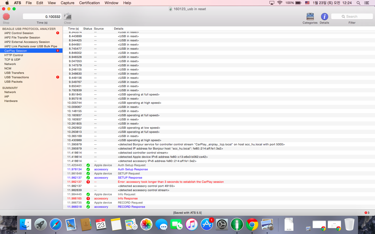

One of my customer is doing MFI (Made For Iphone) cerficaition for her proejct using TUSB211.
The GUI of MFI Tool shows below message when an iPhone is not connected to MFI tool.
Apple Test lab say why  <USB in RESET> message is logged before a USB device is not connected.
I think this message is due to the pluse train from TUSB211 Pin No1.
On the other hands, There is no signal on the DP Pin of TUSB211.
Is it normal operation for TUSB211 and Is there no issues for MFI Certification?
