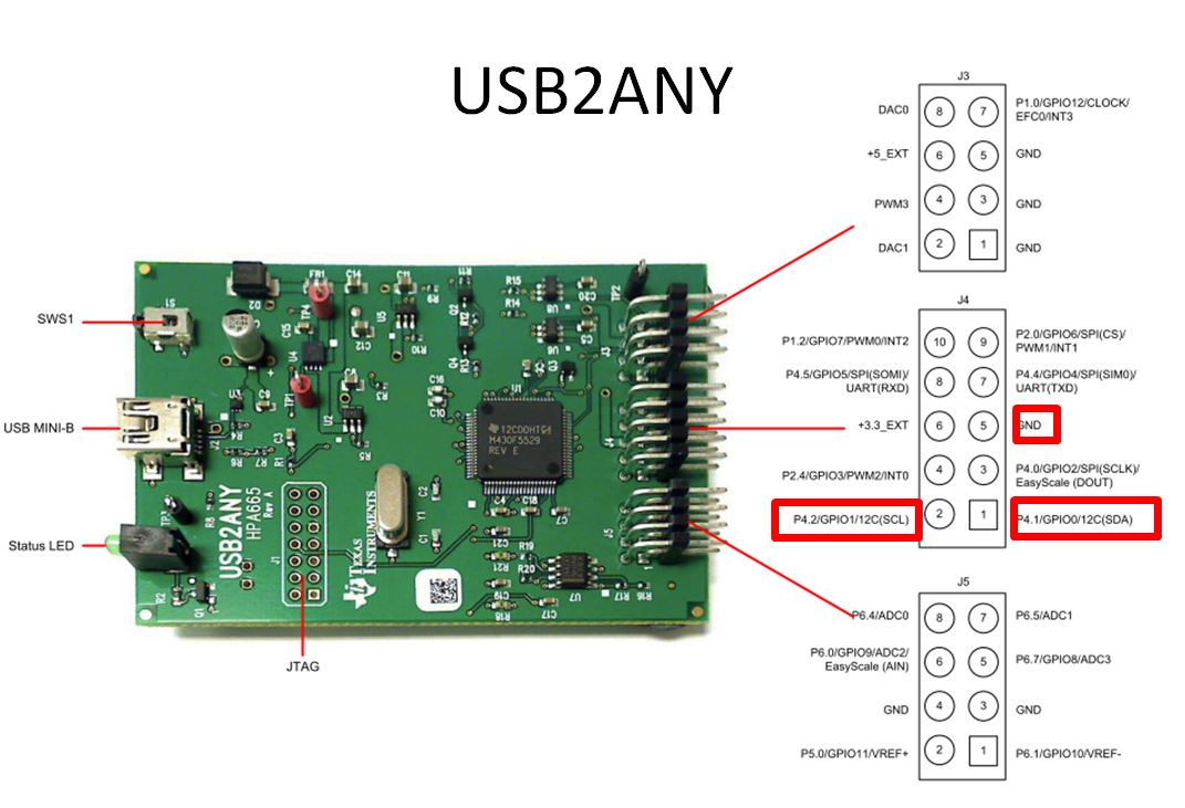

Also , could you please let me know the difference between the DPS dongle and USB2ANY?
Is this pin assign of connector only? If yes, can we use the EVM by USB2ANY?

  • Hi Asaka-san,
    As a slight adjustment to Liang's comment, he is referring to a SPA dongle board circuit integrated on the EVM that supported a previous generation of software used by the DS125DF410, called ALP (Analog LaunchPad). We have used this software to control the DS125DF410 until recently.
    In the past few months, we have upgraded our interface to "SigCon Architect," and the new software exclusively works with a DPS-DONGLE-EVM (or USB2ANY equivalent). We have also recently updated the DS1250DF410EVM User's Guide documentation to reflect this change as well. To acquire a DPS-DONGLE-EVM, please contact our marketing at dps_marketing@list.ti.com.

  • Hello Bugra san,
    I got the DPS Dongle however, my customer is request the I/F board urgently, I used USB2ANY for I/F between PC and DS125DF410EVM.
    And this is no problem.
