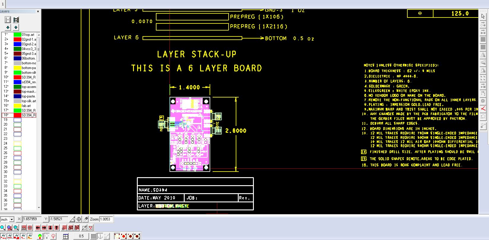

SV600433B_Gerber.zipKawai-San,
We use LMH0394 evaluation module for LMH0384 device. There are two differences:
1). LMH0394 uses 2.5V while LMH0384 uses 3.3V supply.
2). LMH0394 does not require 1uF AEC capacitor between pins 5 & 6 but LMH0384 require this capcitor.
I have attached LMH0394 gerber to this post.
Regards,,nasser
