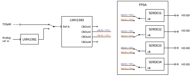

    I have received a document from my customer in which he describes the system and asks a couple of questions. I will reproduce it below.
    Our product is a PCI Express based quad port HD-SDI input + output adapter. Each port can be configured to behave as either input or output. The board relies on the LHM1983 to generate all clocks needed for the serializers and de-serializers (i.e. 148.50MHz and 148.35). In a genlock scenario the board also uses the TOF signals to align its outputs to the genlock reference source.
    The following diagram show the general clocking structure.
    The LMH1983 can get its reference from two possible sources, namely: (1) an external analog reference via an LHM1981 sync separator or (2) from an onboard generated 720p60 reference. Each SERDES can either use the output from PLL2 (for non-fractional formats) or PLL3 (for fractional
    formats).
    There are three general usage scenarios, namely:
    1. No Genlocking, which means the onboard 720p60 reference source is selected. In this mode we want PLL2 to generate a stable 148.5MHz and TOF2 should generate a non-fractional frame rate (as defined by the PLL2 format setting).
    PLL3 should generate a stable 148.35MHz and TOF 3 should generate a fractional frame rate (as defined by the PLL3 format setting).
    Both PLLs do not have to align to the 720p60 reference.
    Until now we have set the TOF alignment for all PLLs to auto, but it is our understanding now that in this scenario it is better to set alignment to never align.
    2. An external non-fractional analog reference is connected, which mean the LMH1983 will be setup to use the reference signal from the LMH1981. In this case we want PLL2 to lock and align to the non-fractional reference.
    PLL3 should generate a stable 148.35MHz and TOF3 with the framerate set by the PLL3 format setting, however it does not have to align to the non-fractional reference.
    Until now we have set the TOF alignment for all PLLs to auto, but it is our understanding now that in this scenario it is better to set PLL2 alignment to auto (or always?) and PLL3 alignment to never.
    3. An external fractional analog reference is connected, which mean the LMH1983 will be setup to use the reference signal from the LMH1981. In this case we want PLL3 to lock and align to the fractional reference.
    PLL2 should generate a stable 148.50MHz and TOF2 with the framerate set by the PLL2 format setting, however it does not have to align to the fractional reference.
    Until now we have set the TOF alignment for all PLLs to auto, but it is our understanding now that in this scenario it is better to set PLL3 alignment to auto (or always?) and PLL2 alignment to never.
    NOTE: in all of the above scenarios PLL1 is set to auto align and PLL4 is not used and left to its default settings.
    Our questions for you are:
    1. Is our understanding correct that if we want a glitch free clock and have no need for alignment we should set the TOF alignment mode to never?
    2. Can the LMH1983 generate a TOF with at a stable interval (set by PLL format) with alignment mode set to never?
    3. Can the LMH1983 create correct TOF pulses when a progressive reference signal is connected (Fin does not toggle in case of a progressive)??
    4. Does the alignment setting of PLL2 have any effect to PLL3 behavior and vice versa?
    5. Do the settings of PLL4 mater if we are not using its clock output at all?
    Henri

  • Hi Henri,
    Before my travel, i noted your questions.
    First of all, thanks for detailed explanation of your overall setup. Please below note responses to your questions.
    1. Is our understanding correct that if we want a glitch free clock and have no need for alignment we should set the TOF alignment mode to never? *NM: Your understanding is correct. I don't call this glitch but call this duty cycle correction between integer vs fractional format conversion in always align mode.
    2. Can the LMH1983 generate a TOF with at a stable interval (set by PLL format) with alignment mode set to never? *NM: Yes
    3. Can the LMH1983 create correct TOF pulses when a progressive reference signal is connected (Fin does not toggle in case of a progressive)?? *NM: Yes we have used Tek TG700 and verified this.
    4. Does the alignment setting of PLL2 have any effect to PLL3 behavior and vice versa? *NM: PLL2 and PLL3 are independent but both use 27MHz PLL1 to genlock to.
    5. Do the settings of PLL4 mater if we are not using its clock output at all?*NM: It does not. I suggest to disable it.
    Regards,,nasser
