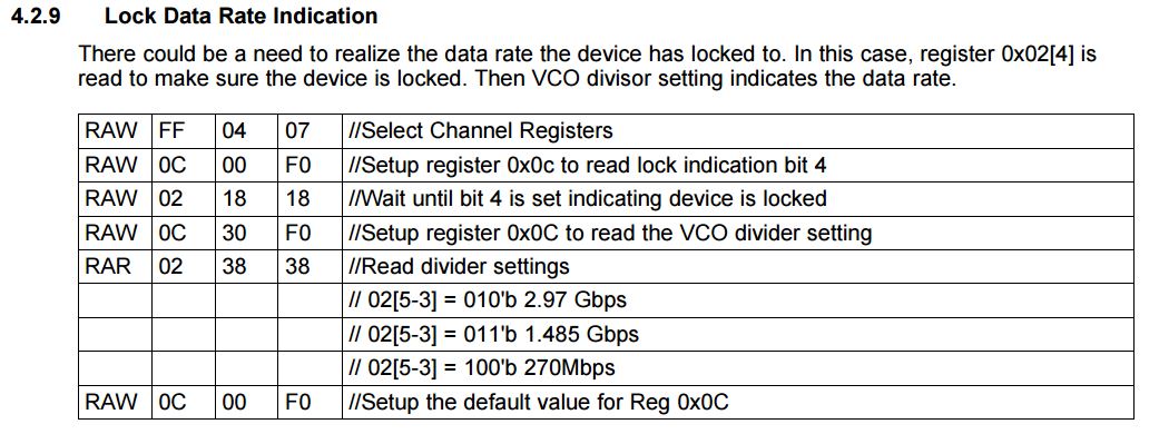

Hello; Is there anyway to read the data rate (SD/HD/3G) from LMH0318 registers?

Hi Karo,
Please refer to Section 4.2.9 in the LMH0318 Programming Guide for details about Lock Data Rate Indication:
Michael
