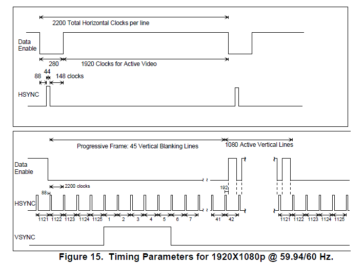

Our customer set the following setting on SN65DSI84 register.
1920X1080p @ 59.94/60Hz (Format 16)
This format is available only in a 16:9 aspect ratio.
Designers should be aware that this format was not defined at the time when EIA/CEA-861 was published.
Therefore, an861 type source box will probably not recognize this format in an 18-byte detailed timing descriptor.

LVDS display does not display test pattern.
However, if they change 0x36 register to 0x25 from 0x24 and 0x3A register to 0x03 from 0x04, LVDS display can display test pattern.
Do we need to add 1 or subtract 1 from original value, when we want to set VBP(0x36) and VFP(0x3A)?
