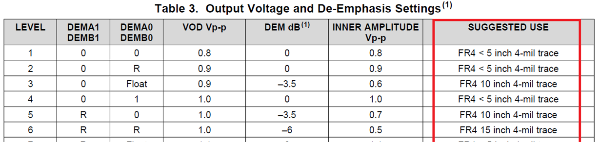

  Q2-2) Data sheet “Table 2”
       There is a “Suggested use” column in Table 2. There describes the “Trace length”
       Does this length include “internal trace length of the card which is inserted to connector” or not?
       Just the length from PCIE slot pin to “ReDriver” pin, correct?
Q3) Emphasis setting
       About the following note(1) of Table 3,
      “The de-emphasis levels are available in GEN1, GEN2, and GEN 3 modes when RATE = Float.”
       Can I understand this note that we should set “RATE” pin as “Float(Auto)” to activate the level
       setting of De-Emphasis? Or the level setting will be also activated by the setting of “1K-GND(Gen1/2)”
       or “1K-VDD(Gen3 with Emphasis)”?

    About "RATE" setting, there is following description on the datasheet page 5.
    "Tie 1K to GND = GEN 1,2" : In this setting, how do we think of "DEM" setting? DEM setting level is also active, right?
    "Tied 20K to GND = GEN3 w/o De-emphasis" : In this mode, DEM setting is not active, right?
    And "Tied 1K to VDD = RESERVED" : In this setting, we should not select. What is the purpose of this?

    Q2) Equalizer setting
    A2) In PCIe it is very common for the CPU and PCIe Cards to use Tx Preset 7.  This setting has a large amount of boost, so the best DS80PCI800 setting is usually much lower than the datasheet suggestions.  I would start with an EQ setting of "Level 1". EQx1=0 EQx0=0
    Q3) De-emphasis setting
    A3)  Setting the RATE pin to "Float" is recommended.  An internal rate detection circuit will sense GEN2 or GEN3 automatically.  Usually a DEM setting with 0 dB or - 3.5dB will work best in PCIe applications.  I would start with Level 4 or Level 10.  PCIe CPU and Cards have built in CTLE circuitry to help compensate for some of the trace attenuation.

    But let me confirm one thing as below about RATE setting.
    RATE : "Tie 1K to GND = GEN 1,2"
    In this setting, Can I understand that DEM setting level is also active?
    Thanks in advance, Regards,
  • Hi Takumi-san,
    Yes, the DEM setting is active when RATE pin is set to GND with 1K resistor.
