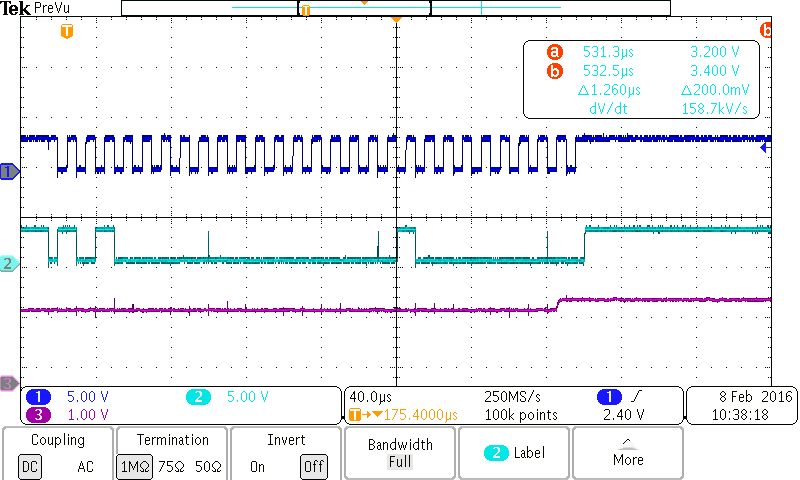

    The WA and WB terminals do not become floating during the wiper response time. I got a scope shot of the TPL0102-100 with HA at 3.3V and LA at 0 V. I changed the I2C wiper register setting from 0x70 to 0x80. Here is the scope shot. The device smoothly transitions.
    Rajan
    Dark Blue: SCL
    Light Blue: SDA
    Purple: WA

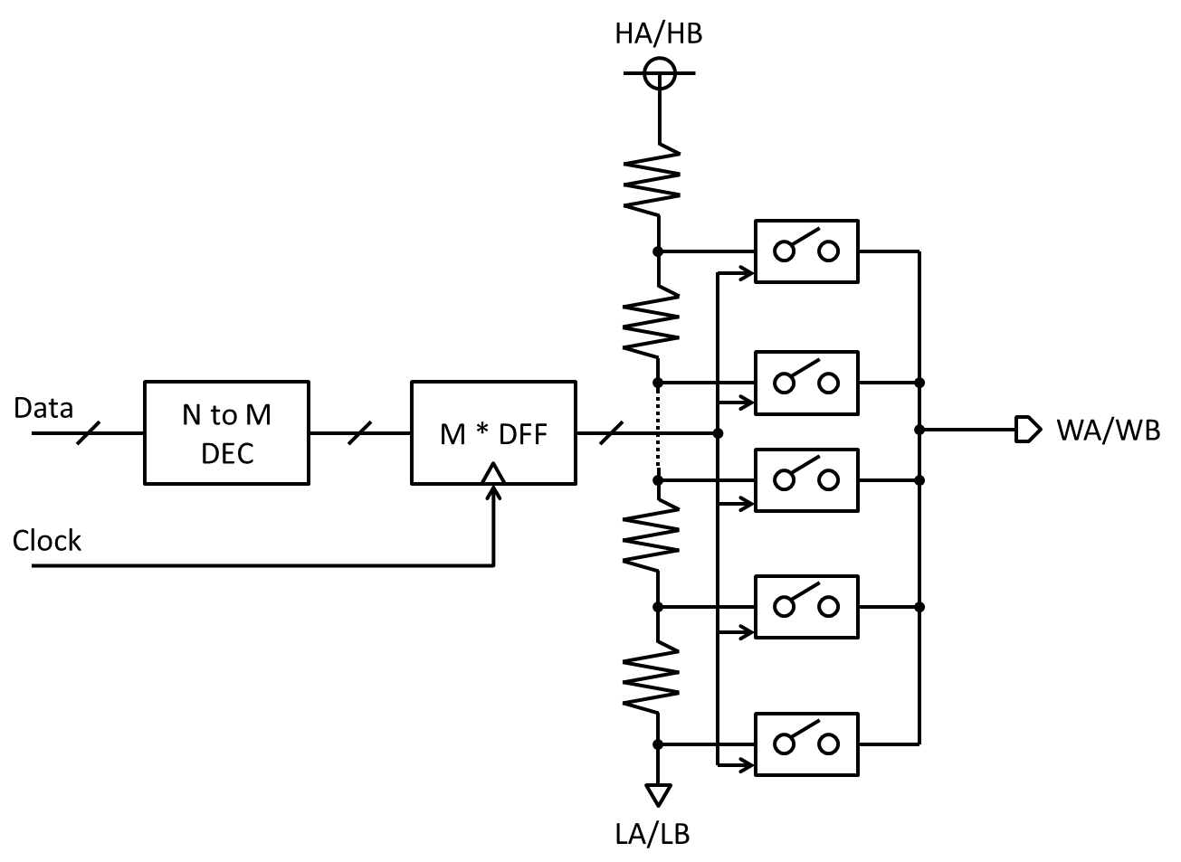

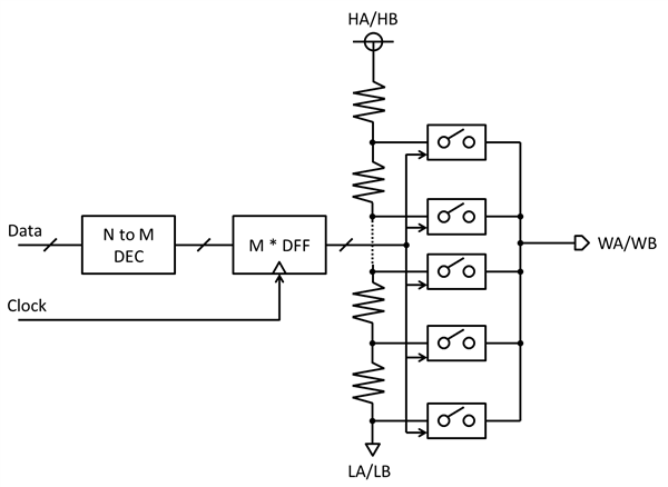

    In addition, I believe that it depends on the architecture whether WA/WB terminals become a floating during the a wiper response time.
    For example, WA/WB terminals would be not a floating almost since the transition timing is synchronized with the clock in the following case.
    Could you please tell us the architecure for TPL0102-100 ?
    Kato

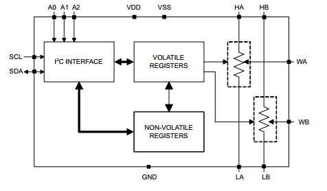

  • Hi Kato-san,
    The architecture details i can share with you is the one shown in the Datasheet diagram below. The device has two resistor ladder and switches control which resistor value is selected (similar to the diagram you shared). The switches are controlled by the digital signals based off serial communication from I2C interface.
    We evaluate the wiper response time with a scope load of ~10pF probe capacitance and ~ 10 Mohm load impedance (typical for scope probes). I tested with ~ 1 Mohm load impedance resistor between WA and GND, and do not see any significant change in wiper response time.
    Rajan
