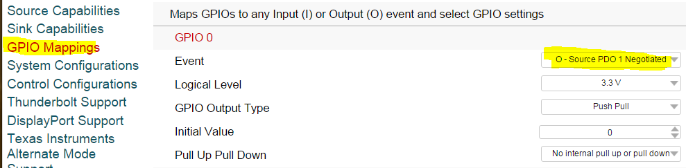

    The TPS65982-CONFIG FW Config-Tool easily lets you modify the default FW image to match your new HW settings. These are some of the selections you will need that are different than the "Load Defaults
    He are some HW guidelines you may want to think about:
    • PP_CABLE: You will still need to provide up to 500mA on PP_CABLE, so you will need to disconnect PP_CABLE from PP_5V0 and use a 2nd (cheaper) DC-DC to generate 5V (the TPS65982 limits at 600mA to account for a little overhead)
    • 12V-5V Transition: The only timing concern you will have is "bleeding" the voltage down to 5V after a 12V contract has been interrupted by a PD Hard Reset or ended via un-plugging the Type-C connector.
    • A GPIO Event can be used for this also, but Source PDO0 Event will not bleed current on an un-plug event (I will see if there is an ideal event to use)
