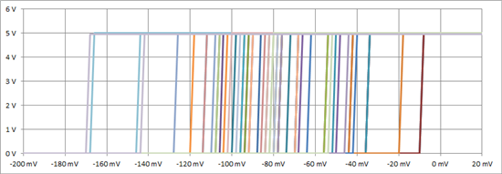

①Before, I posted below E2E forum, is AM26LV32C have graph similar AM26LV32E?
 (Is AM26LV32C graph same as AM26LV32E?)
https://e2e.ti.com/support/interface/industrial_interface/f/142/t/345257
②In the same before E2E forum written
"The AM26LV32E has a better fail safe that is missing the potential issue that the AM26LV32 has.",
How was AM26LV32E inprove?

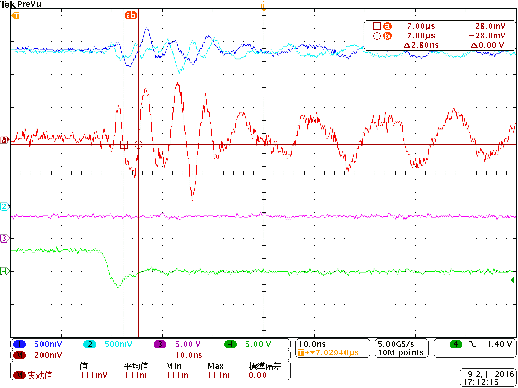

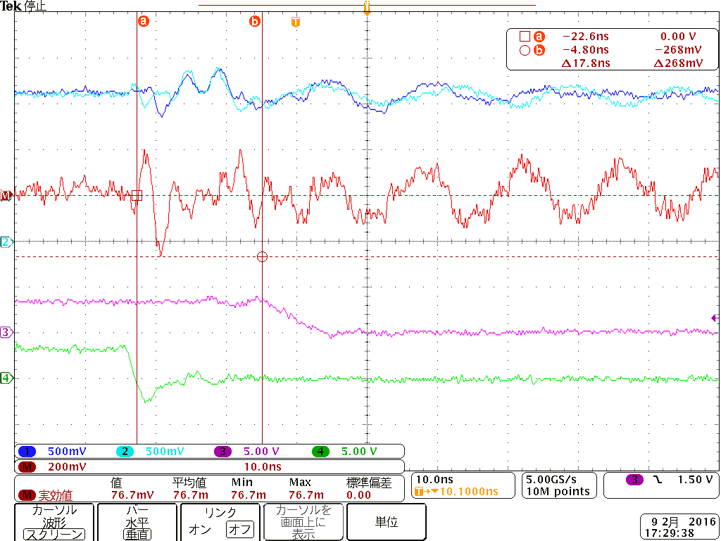

③In the case of tesetd same board (replaced AM26LV32C to AM26LV32E on test circuit),
Output results were differ.(AM26LV32C:Output Low, AM26LV32E:Output High)
What could be the reason?
※Test data is attached.
CH1:IN+(xA), CH2:IN-(xB), CH3:OUT(xY), ch4:Clock
・AM25LV32C
・AM26LV32E
