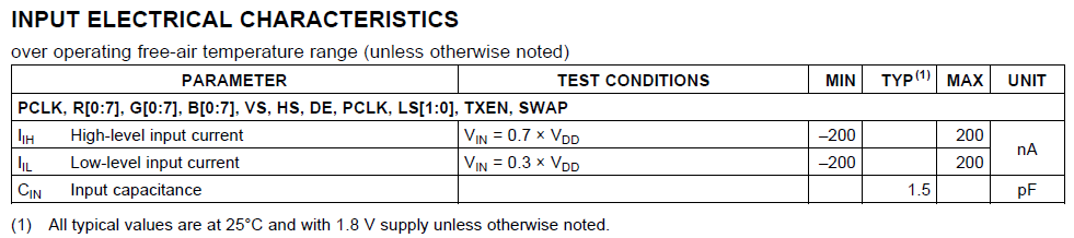

Is our understanding corret that SN65LVDS311 does not have the internal pull-up/down resistor for TXEN pin since the input current is +/- 200nA as below ?

Hi Diego-san,
Thank you for your prompt reply.
I understood and will inform our customer of your information.
