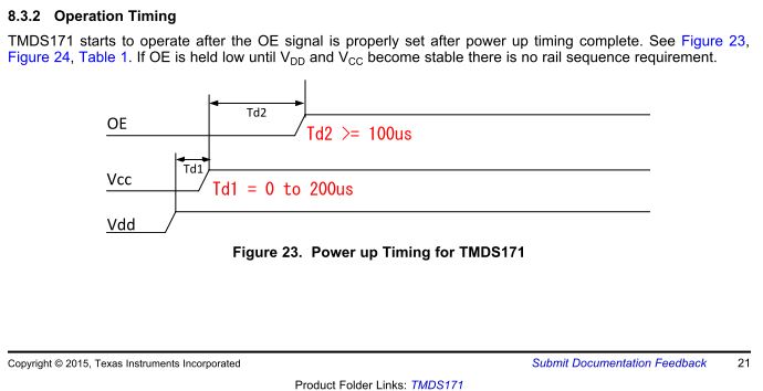

Hello Team,
For the power up sequence of TMDS171, Td1 range is from 0 to 200us. What happens if user has larger delay time to power up Vcc after Vdd ? Do you strictly need to control this power up timing, Td1 range ? Our customer has ms order delay time.
Kawai
